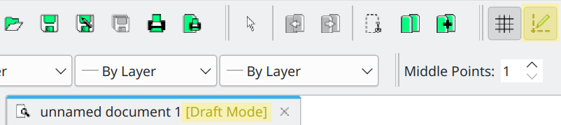

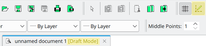

There is the tool icon in the View toolbar and the View menu.
Also the tab or window title is marked with [Draft Mode].
Draft mode can also be toggled with the shortcut Ctrl+d
