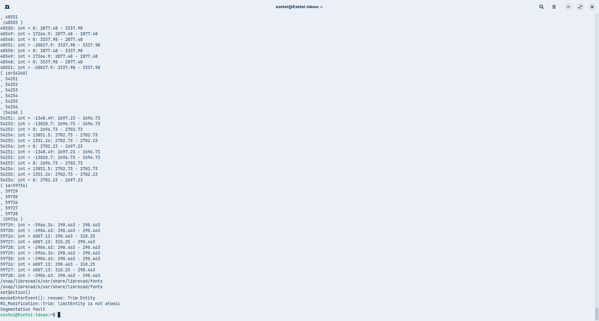

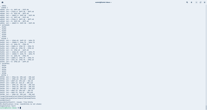

Ok, not all solved. However, I did see where I went wrong in trying to recreate the crash. When I tried to trim two lines, I accidentally selected a dimension line, instead of my wall line and I can see that that does not work.
It doesn’t explain why V2.2.1.5. kept progressively crashing worse in the last week after having it used with no problems for over a year, but the version I switched to seems to be working fine. Memory check came out OK.

Could you find steps to reproduce the issue or the call stack of the crash?
I haven’t reinstalled the first version to recreate the crashes. I don’t recall what prompted the crashes initially, but it ended with just trying to open the ‘Current Drawing Preferences’. However, I think most functions at that point caused the software to quit.
